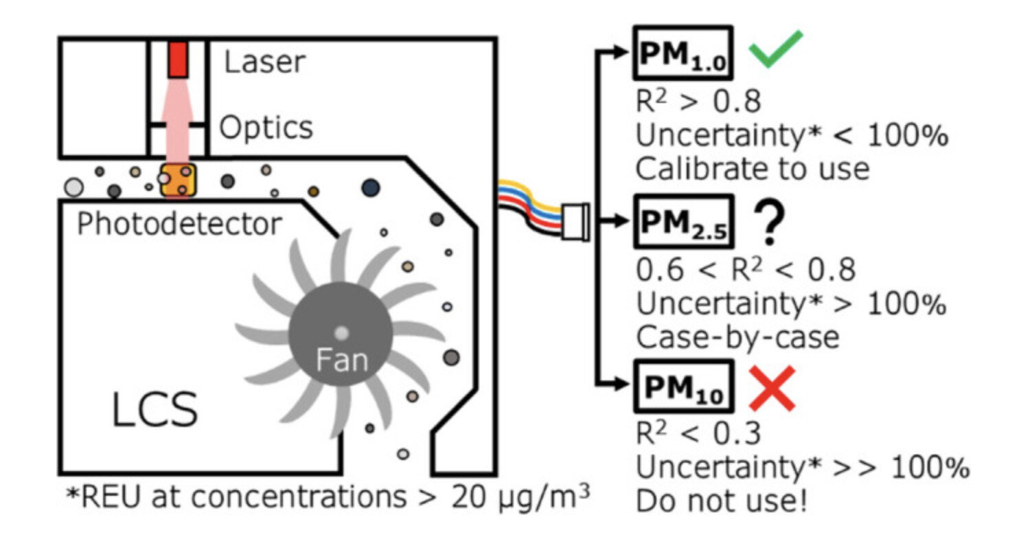

For a long time in my air quality monitor reviews, I’ve been stating that you probably shouldn’t rely on PM10 readings from any low cost air quality sensor. But why is this? It mostly comes down to the fact that low cost sensors (LCS) just aren’t very accurate when it comes to PM10. The image below (from this study) shows exactly how inaccurate LCS can be when it comes to PM10.

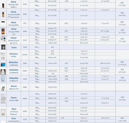

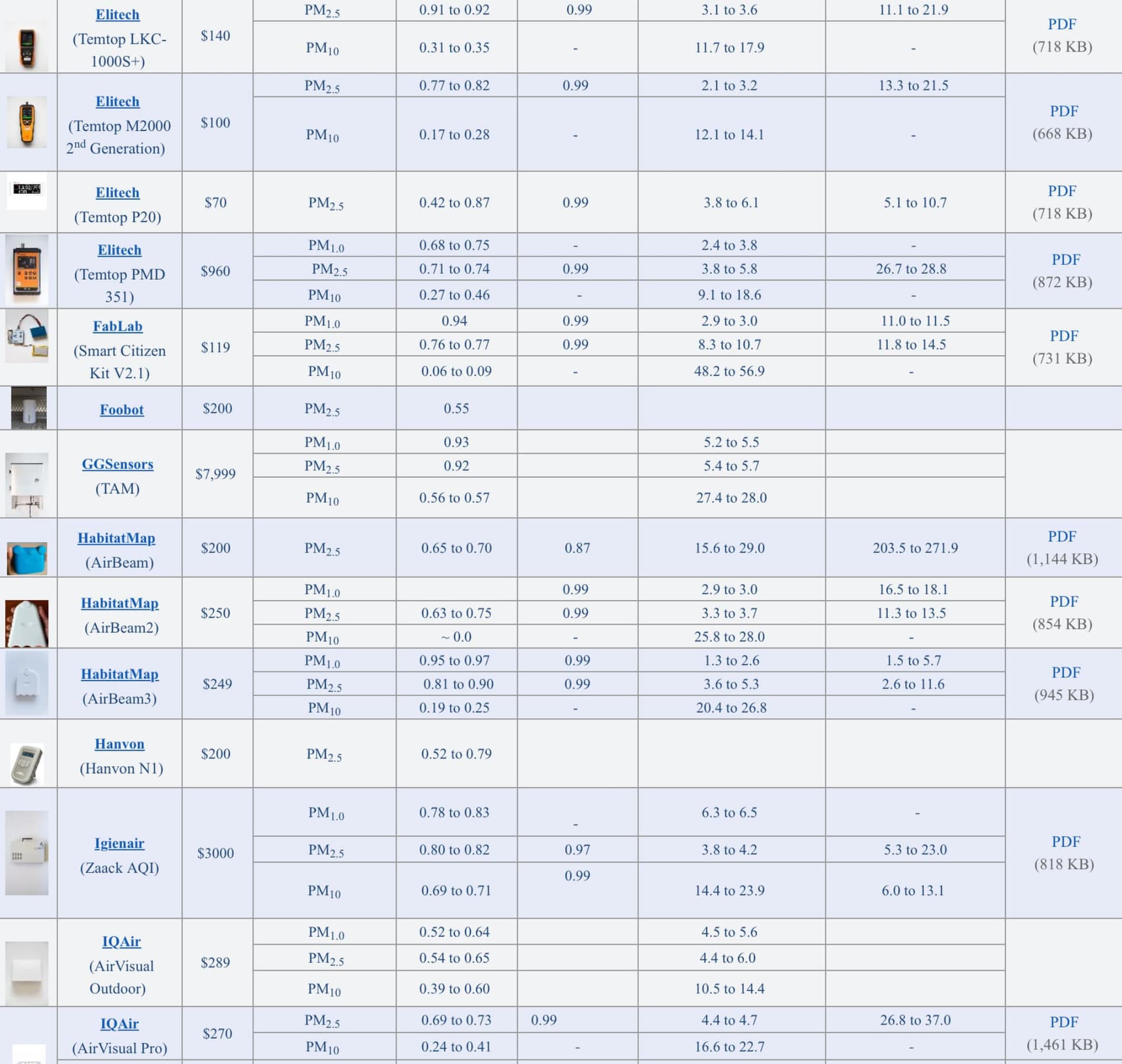

As you can, and as is probably surprising for many, LCS are typically far more accurate when it comes to PM1 and PM2.5 than when it comes to PM10. This can also be seen in other third-party testing, such as that by AQMD’s AQ-SPEC:
Notice how the PM10 accuracy tends to be far lower than PM2.5 and PM1? For even more examples across other databases, you can also view this article. But why is this? Well, there are a few key reasons:
