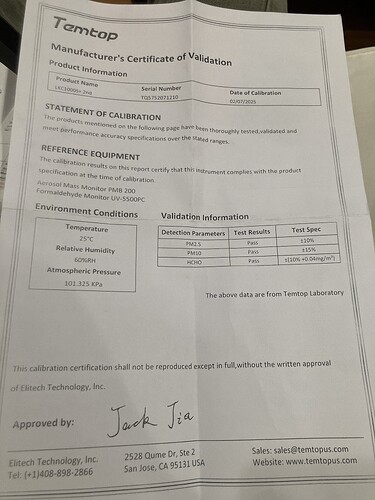

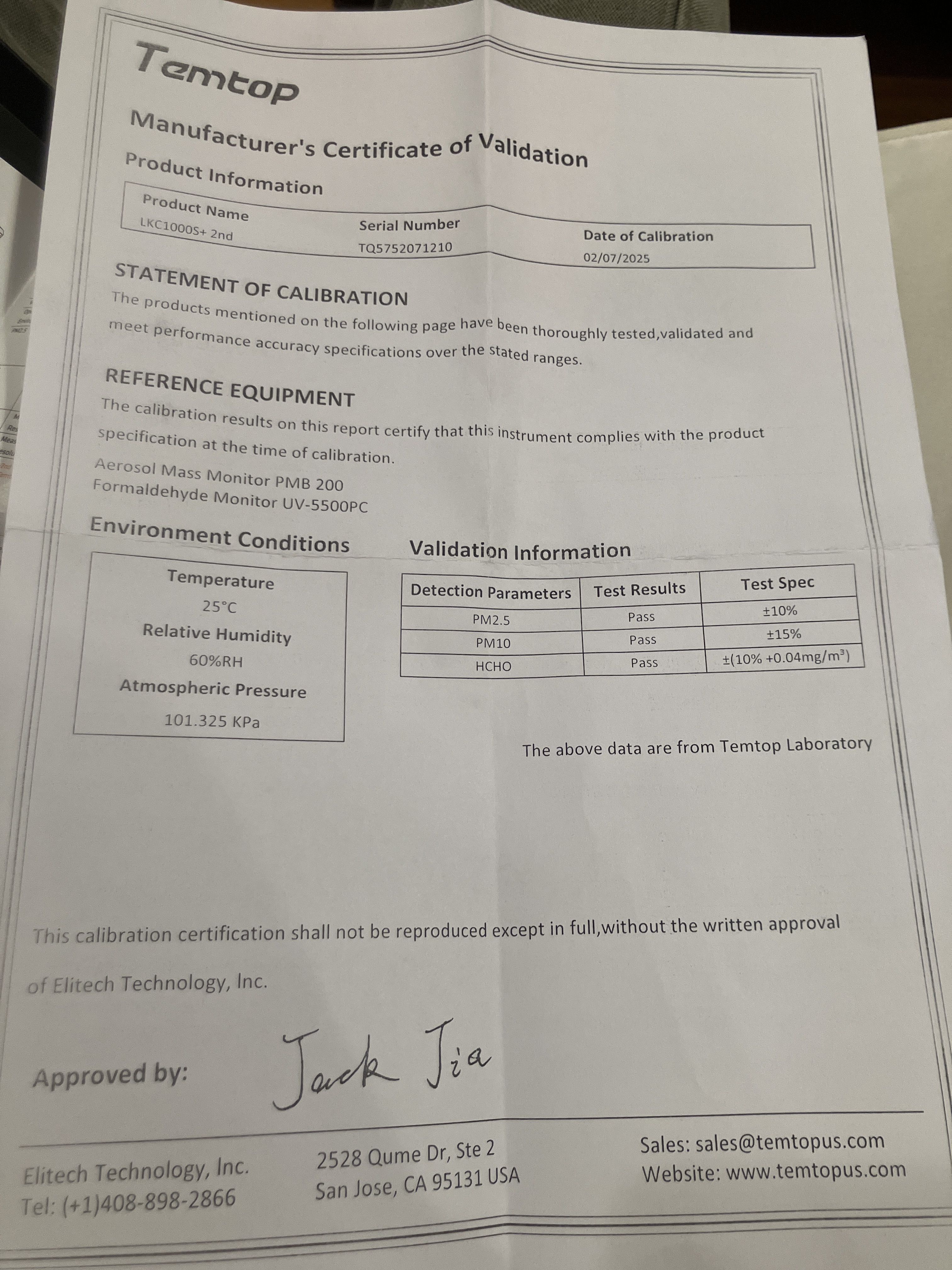

I have since purchased the Temtop LKC10005+2nd air quality detector. Which also was accompanied by this certificate of calibration as seen in this image below
I subsequently closed the doors to the bedrooms and after one hour placed the detector in the room in various spots for 10 mins each. The VOC readings were apparently low ranging from 0.18-0.24 and detector stated that the air was “healthy”
Would you please be able to tell me if I can trust these readings to be accurate?

Firstly, I just want to say that I don’t have much experience with Temtop’s more ‘professional’ air quality monitors, but it’s great to see they come with a test certificate. While I’ll have to do more digging into the reference equipment they use, it’s a nice touch.

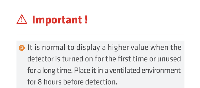

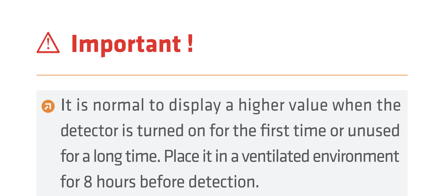

Since I’ve never used this monitor, and since Temtop tends to not give too much information about its devices, it’s hard to tell exactly how good the VOC sensor is. However, I assume that it is like other low-cost VOC sensors, meaning that outputs given should only be considered relatively (even if the output is shown as an absolute value). In other words, these sensors good for showing trends, but they can’t pick up absolute concentrations.
Based on this first warning in the user manual, I think it’s the same case here and I wouldn’t rely on any absolute readings from the device. That said, we can still get some useful information from it!
It sounds like you’ve used the device correctly, and if it’s only shown a relatively small jump in VOCs, then I would guess it’s likely correct and there’s not too much to worry about. If you take the device outside for a while (or place it near an open window) and then put it in a room that wasn’t recently wallpapered, how does it react? I would guess the concentration increases, but not as high as 0.18-0.24. If this is the case, I don’t think you have much to worry about, but it would be great to air the room out as much as possible for a week or two.
