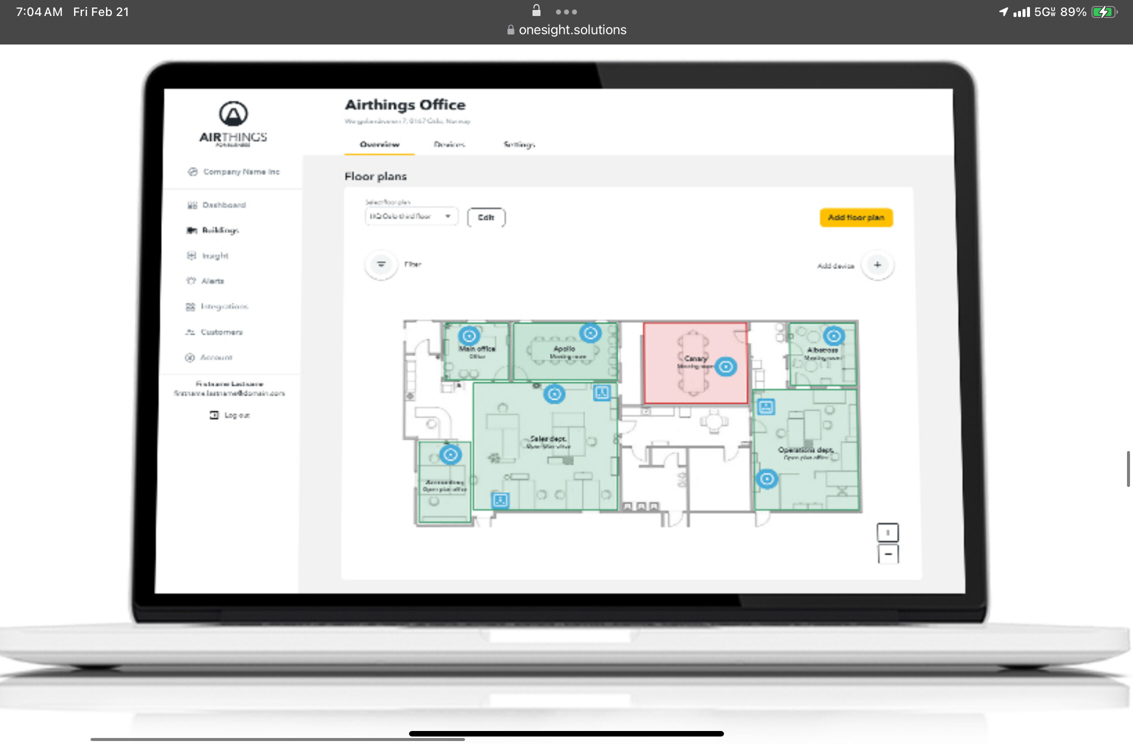

Help! I’m about to launch headfirst into home air quality management, and what I want to do is repurpose tablets to always display air quality throughout my house in graphical form, specifically a floor plan of my house showing each room as green or red depending if one sensor value is out of whack. I’ve seen pictures of an Airthings Business dashboard (below) that might do the trick, although it’s still not clear if that dashboard could be used with the home sensors, or if the regular dashboard has the same option, and what exactly triggers the color change.
I think I would rather use AirGradient sensors, so I’m curious if the same type of thing can be done with AirGradient, or if there is another product or software that does what I’m looking to do.

Hi @dcpmark, thank you for joining and fantastic question! This isn’t something I see mentioned very much.
As for Airthings, I can’t confirm with certainty, but I can’t see this option in my dashboard. As such, I believe it may be a feature that is limited to the business dashboard.
