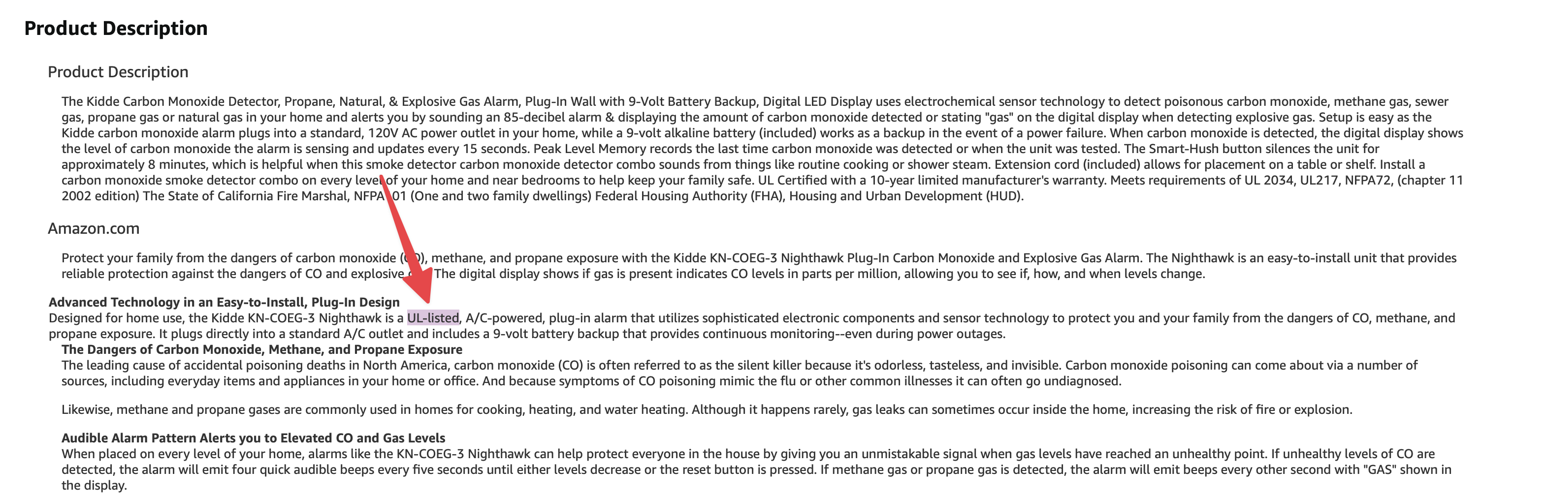

It seems that both of the monitors you’ve mentioned are UL-listed.

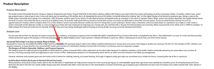

Kidde:

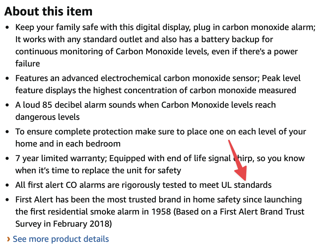

First Alert:
I also had a look through both websites and spec sheets (which I would trust a lot more than Amazon listings), and these look to confirm that both are UL-listed.
To answer this, I actually quite like the idea of the two-in-one monitor. Overlooking other features, I think having an explosive gas sensor (methane, propane, etc) would be a nice added peace-of-mind feature. With that said, the Kidde device in question looks to have quite bad reviews. Also, while the device is UL-listed, I can’t find an answer as to whether this only applies to the CO sensor and features or also the explosive gas sensor and features.

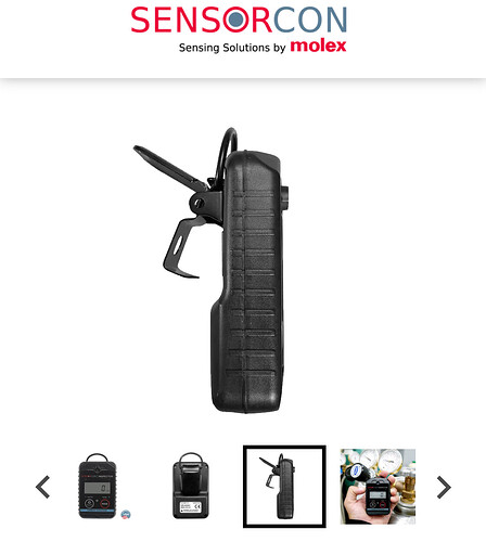

I’ve just joined the forum to respond to this question. I was frequently traveling and needed a portable CO monitor to exist safely around various type of gas kitchen appliances and heaters (often unflued - Australia I’m looking at you). Settled on this brand. Great battery life, features, and sensor life: Buy Portable CO Detectors & Gas Detectors Online | Sensorcon

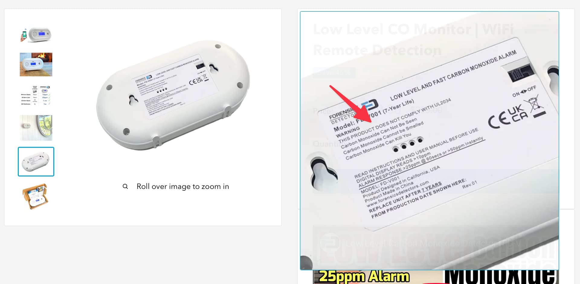

Low level units are NOT UL2034 because they dont follow the UL2034 alarm algorithm, which is first alarm at 70ppm at 60 minutes. Low level units typically are more sensitive and faster to alarm than UL2034 algorithms and hence, for those that want to compliment their existing UL2034, one should seriously consider it. For example, Forensics Detectors low level alarms follow alarming at 25 ppm at 60 seconds. Much faster than UL2034, and useful for elderly, young, families and those that want earlier warning.
Also please note, UL2034 does even alarm at OSHA exposure limits. So please send the message that UL2034 is not end all be all when it comes to CO detection and early warning.
Here is a image of a typical disclaimer people often miss when purchasing a UL2034 CO detector.

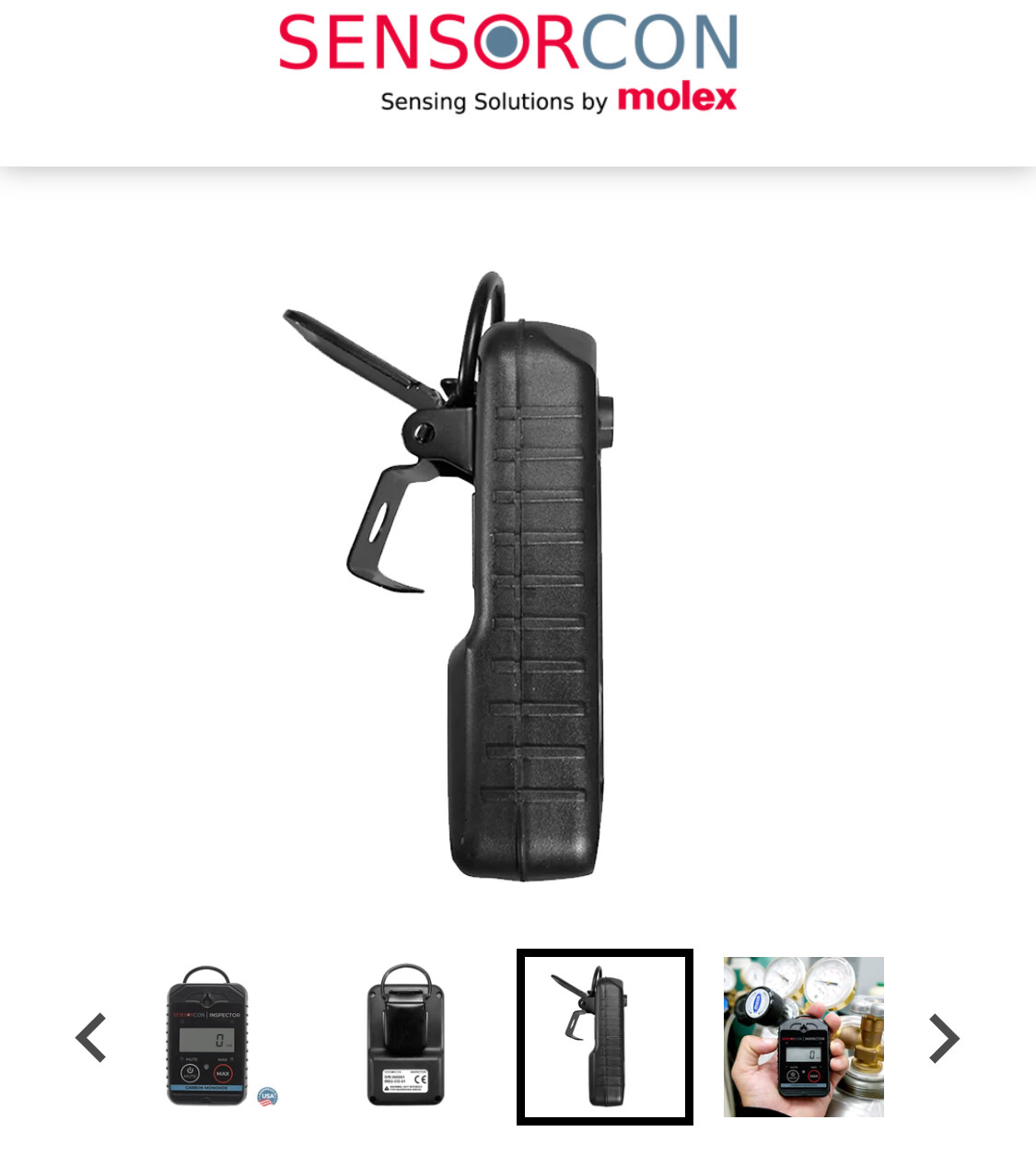

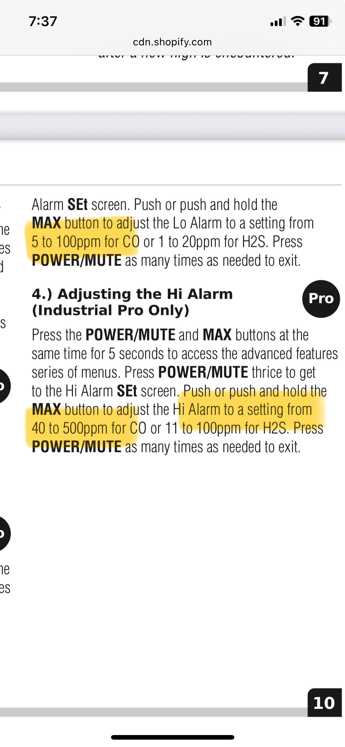

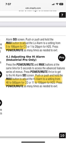

@Ethan the SensorCon units all have alarms but the Industrial Pro model has configurable alarm levels down to 5ppm.
The Sensorcon units have a loop and clip on the back. Makes it easy to position
near head level when working in a kitchen, to hang from a luggage strap when traveling in old buses, and so on.
